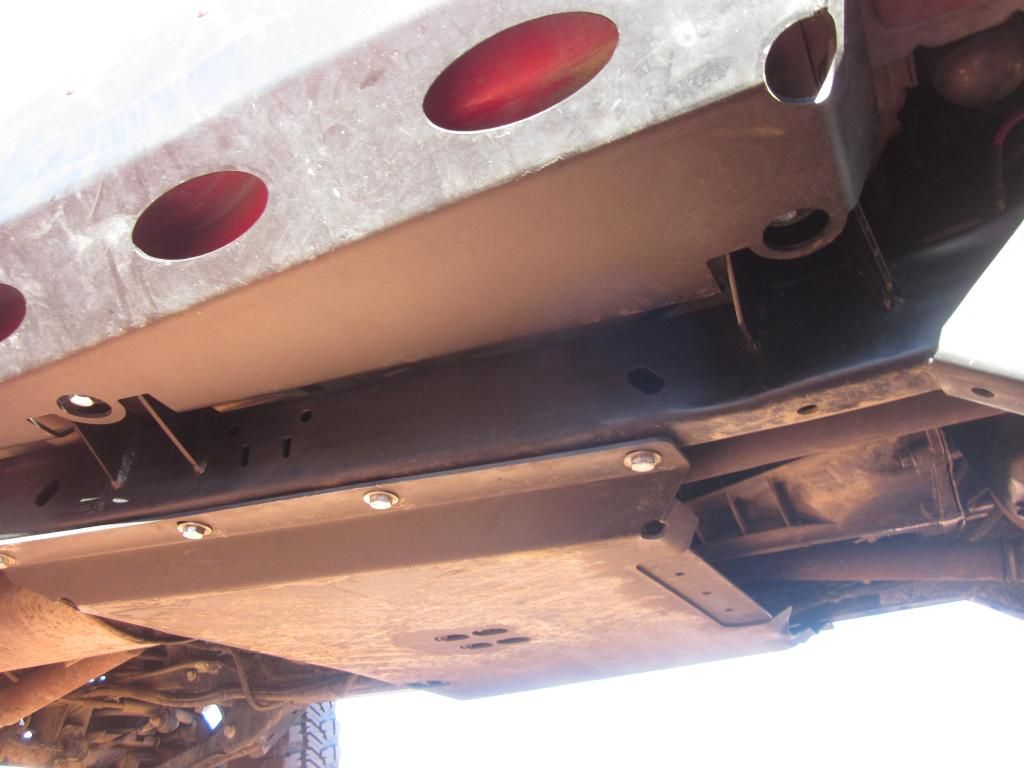

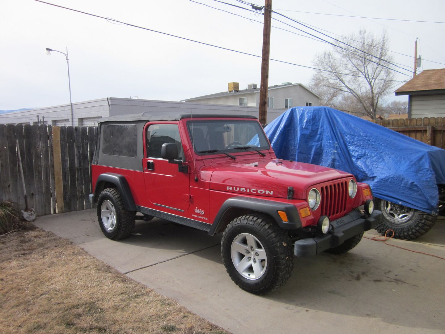

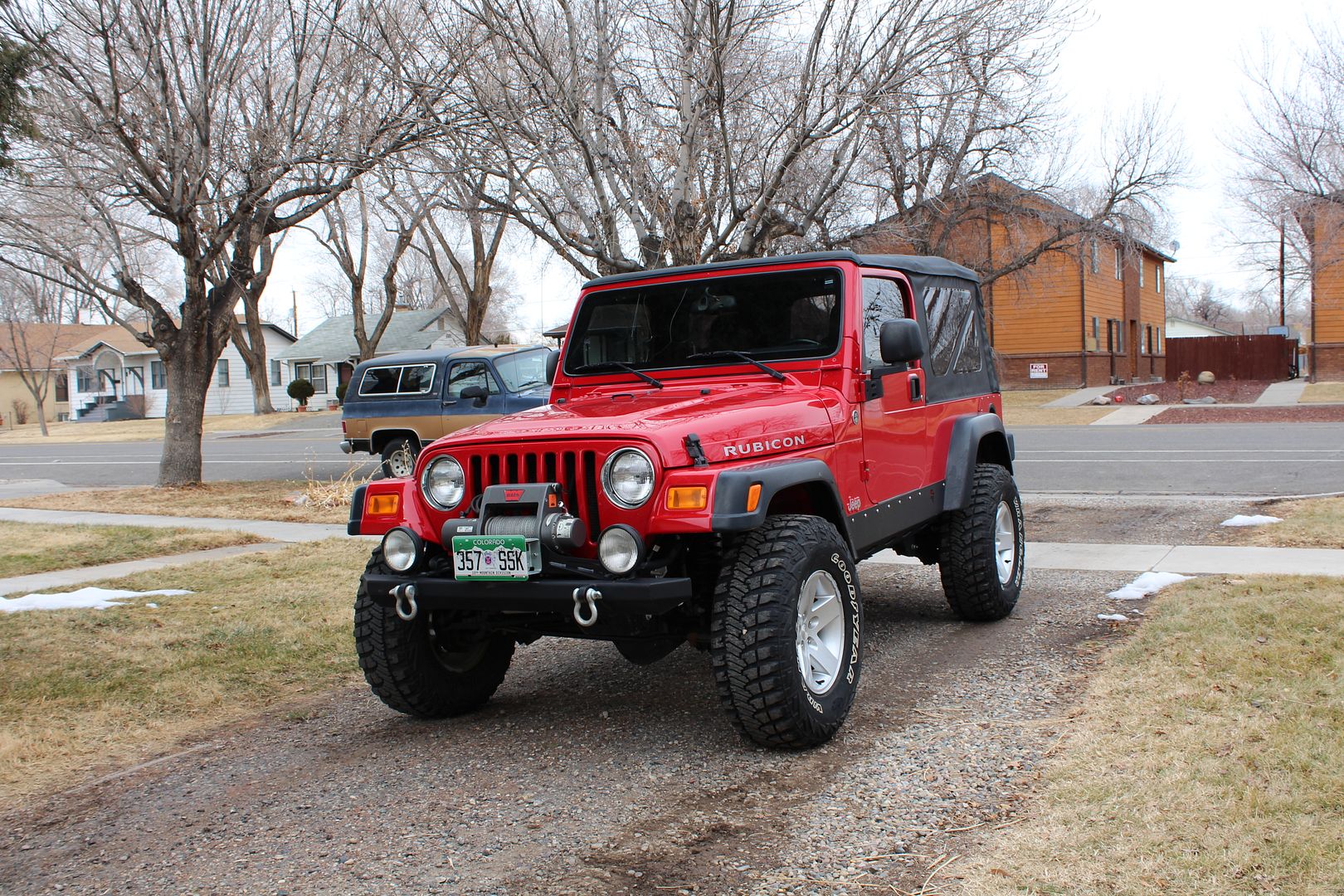

    Then we placed a call to Rod at TnT customs and got their belly up skid to compliment the motor mount and body lift, which will gain us 3" of clearance over the stock Rubicon skid. This weekend we got the lift on, and the front bumper/winch. The jeep is off to Shrums Automotive in Junction this week to get all the fluids flushed and to replace a leaking axle seal on the front 44. Next weekend we'll wrap up the rear bumper/tire carrier, install the body lift, motor mount lift and belly up. With out the rear bumper she's sitting a little high in the front. Only issue we ran into was one of the upper shock bolts snapped off in the tub. I was too tired and frustrated to think about using my welder to weld a nut on it and back it out, so i'll have to come back next weekend and some of the bolts weren't lining up very well with the Smittybuilt bumper brackets in the rear, so i'll have to grind mounting brackets down a little before installing the rear bumper next weekend.

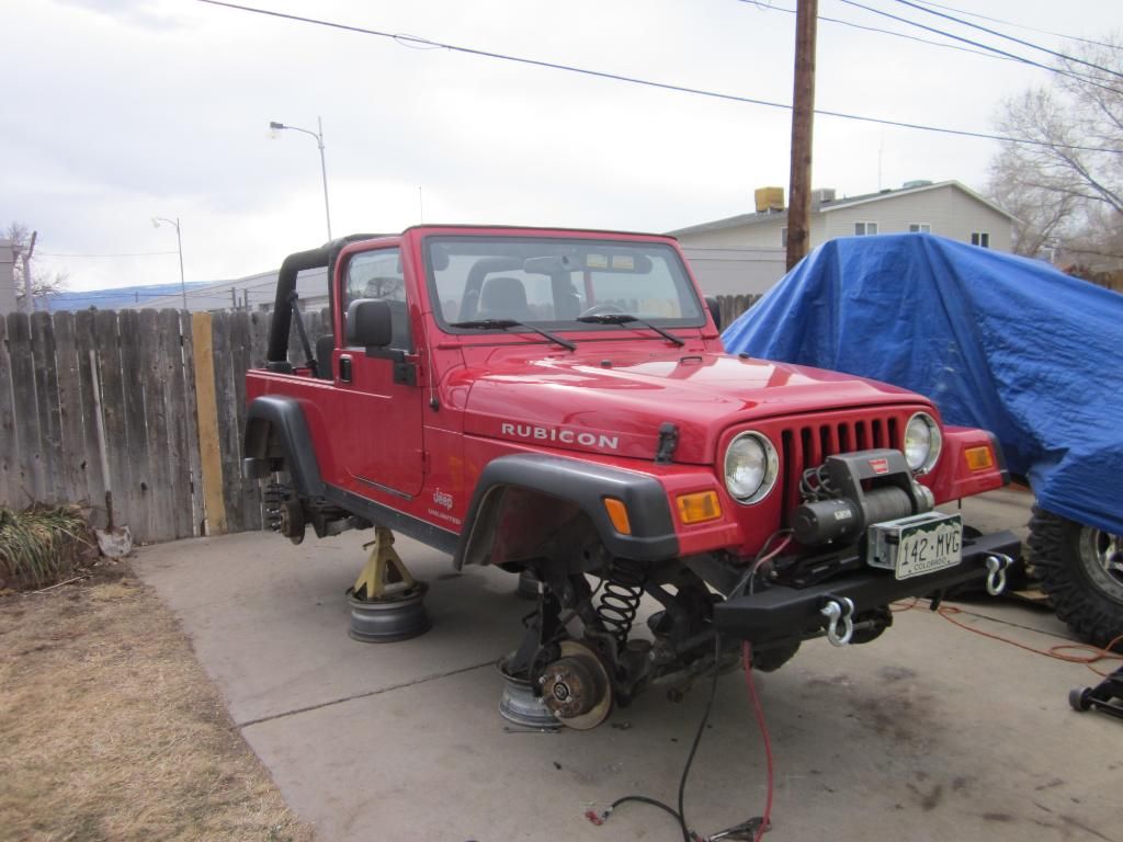

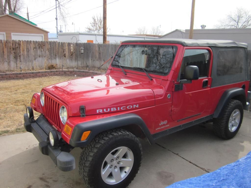

    Bone stock ready for some goodies

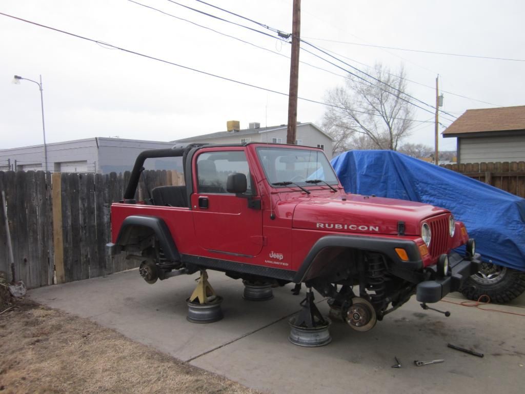

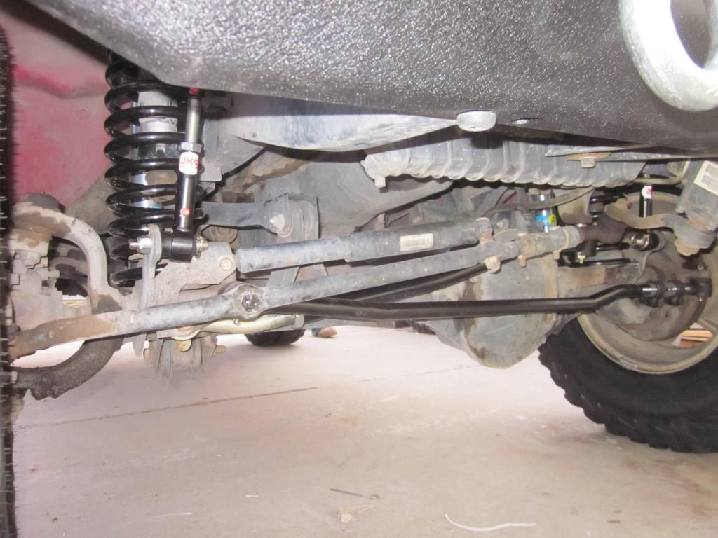

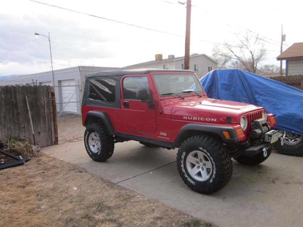

    getting under way

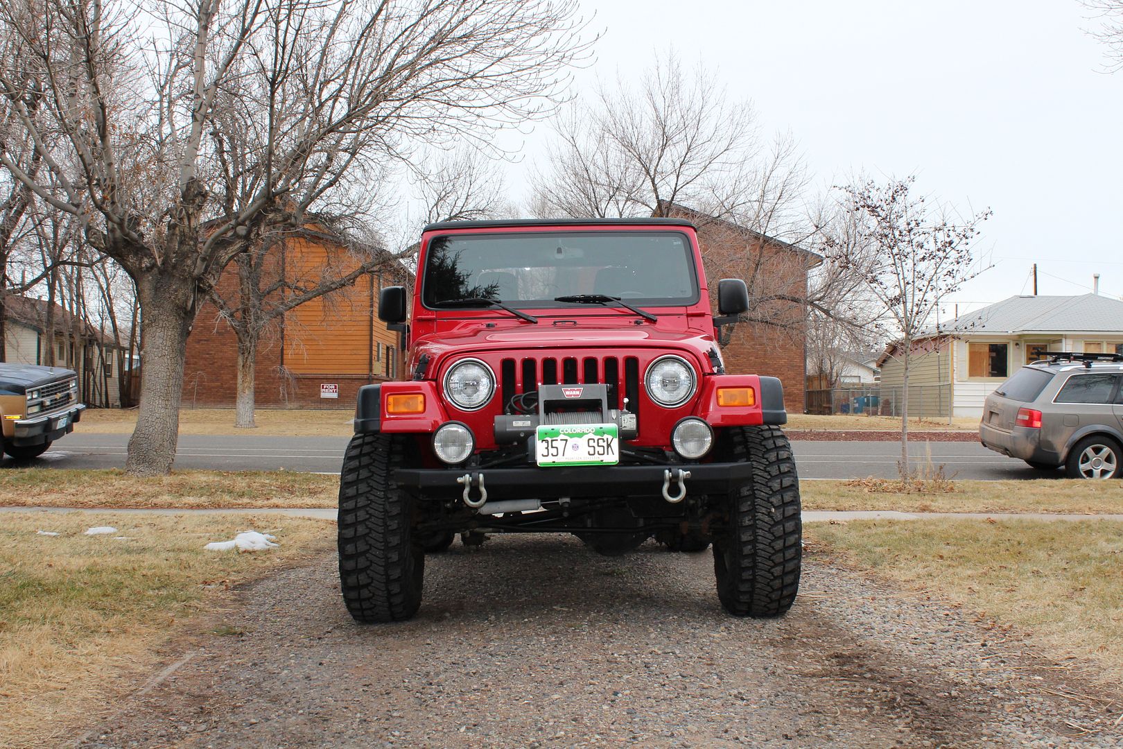

    Got the front bumper/winch/steering box skid on
    Front is done, onto the rear

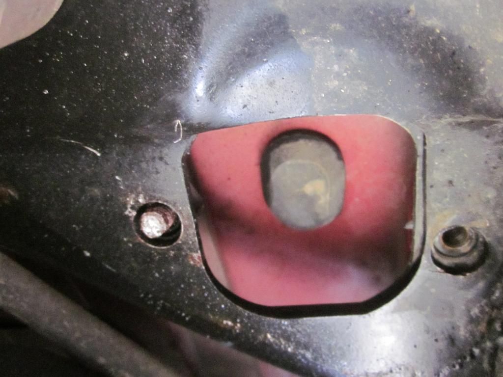

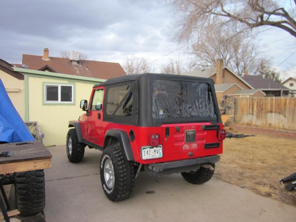

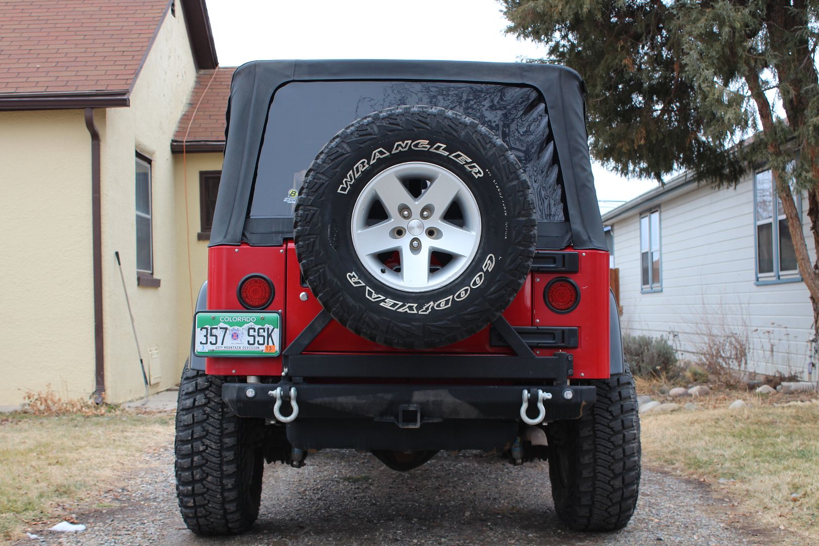

    Welded the rear track bar relocation bracket on vs drilling out a bunch of holes in a really tight space

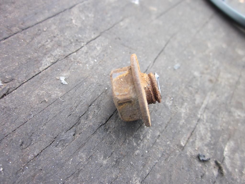

    Then a bolt snapped on the driver side upper shock and I was so frustrated i didn't even think to use my welder to weld a nut on it and back it out

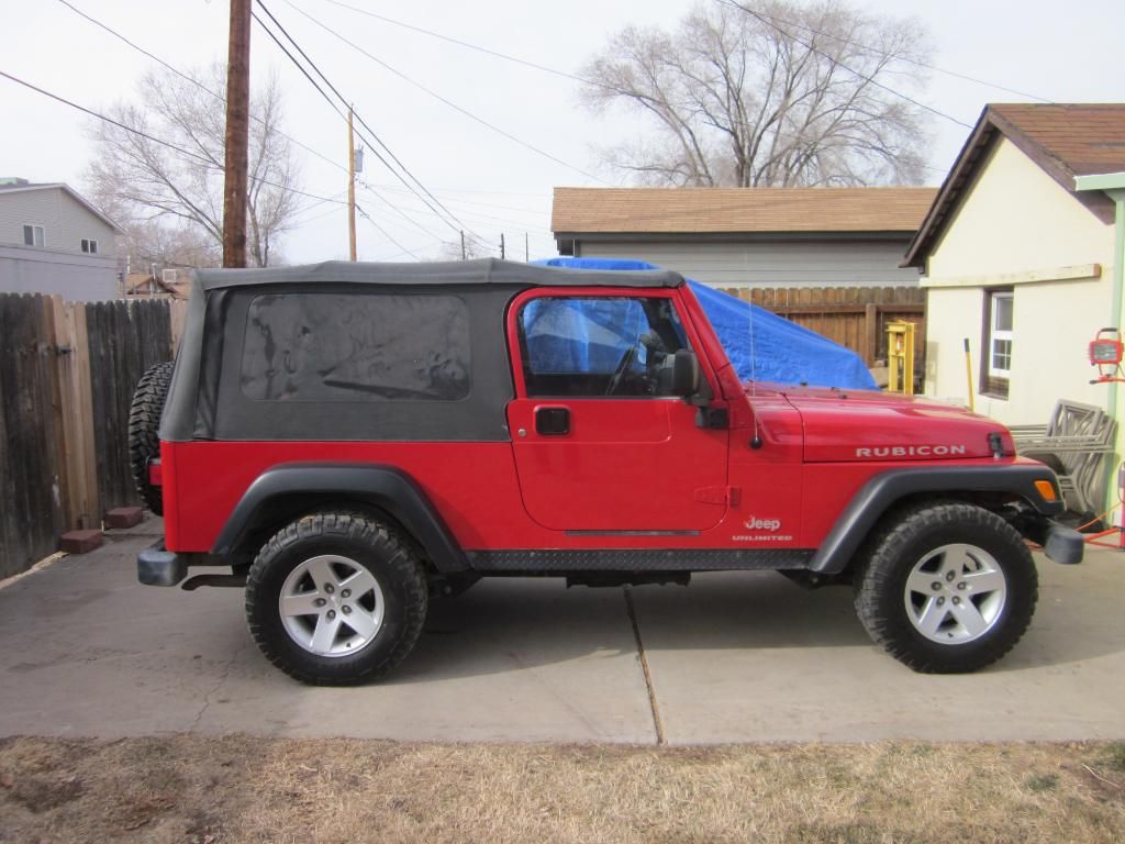

    Ok, done for this weekend, as I said the rear is sitting pretty high without the bumper/tire carrier/full size spare, causing the front to sit even lower. Tune in next weekend and we should have the corners on, body lift, motor mount lift, tummy tuck and LED's.

    Very nice. It is pretty common for those bolts to snap and they are difficult to get out.

    The tail hig thing is very common with OME lifts. You may end up needing to add some spacers to the front coils to level it out, even after the rear bumper is installed.

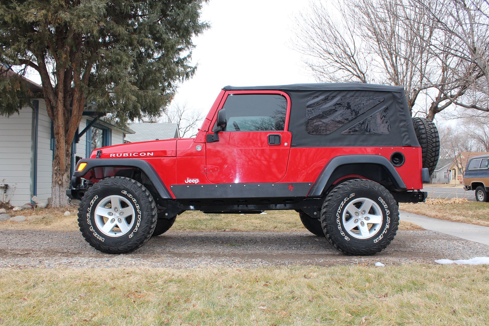

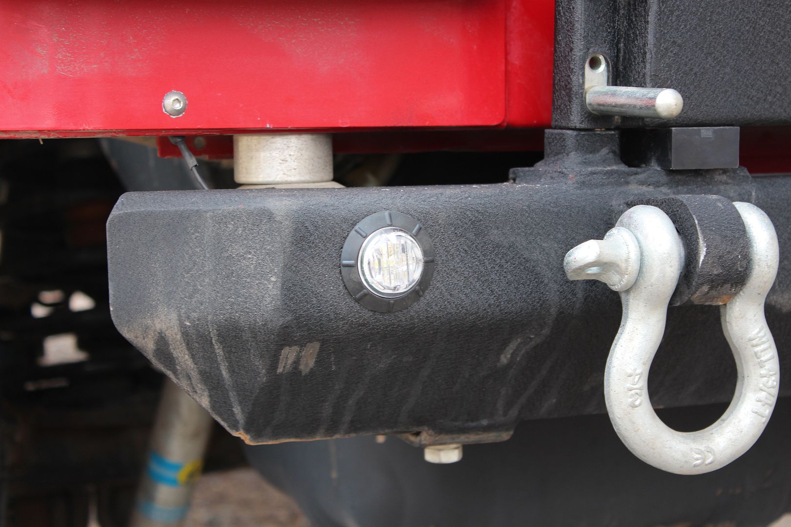

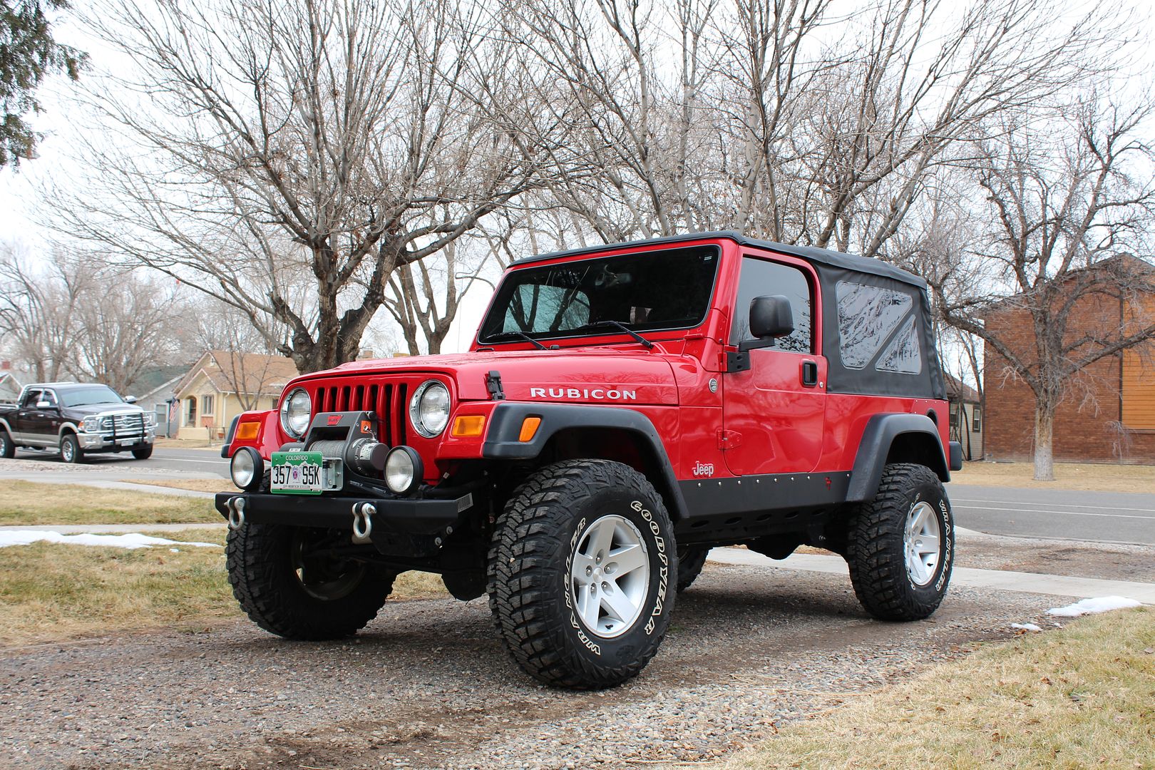

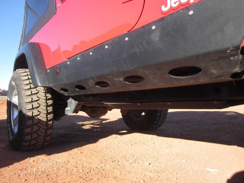

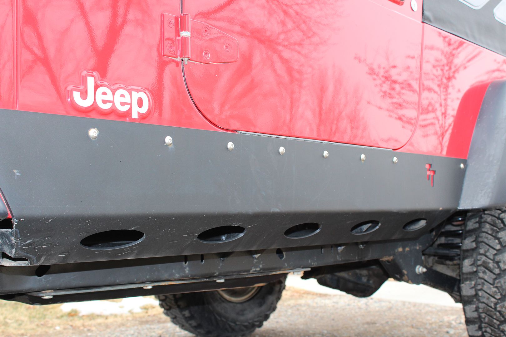

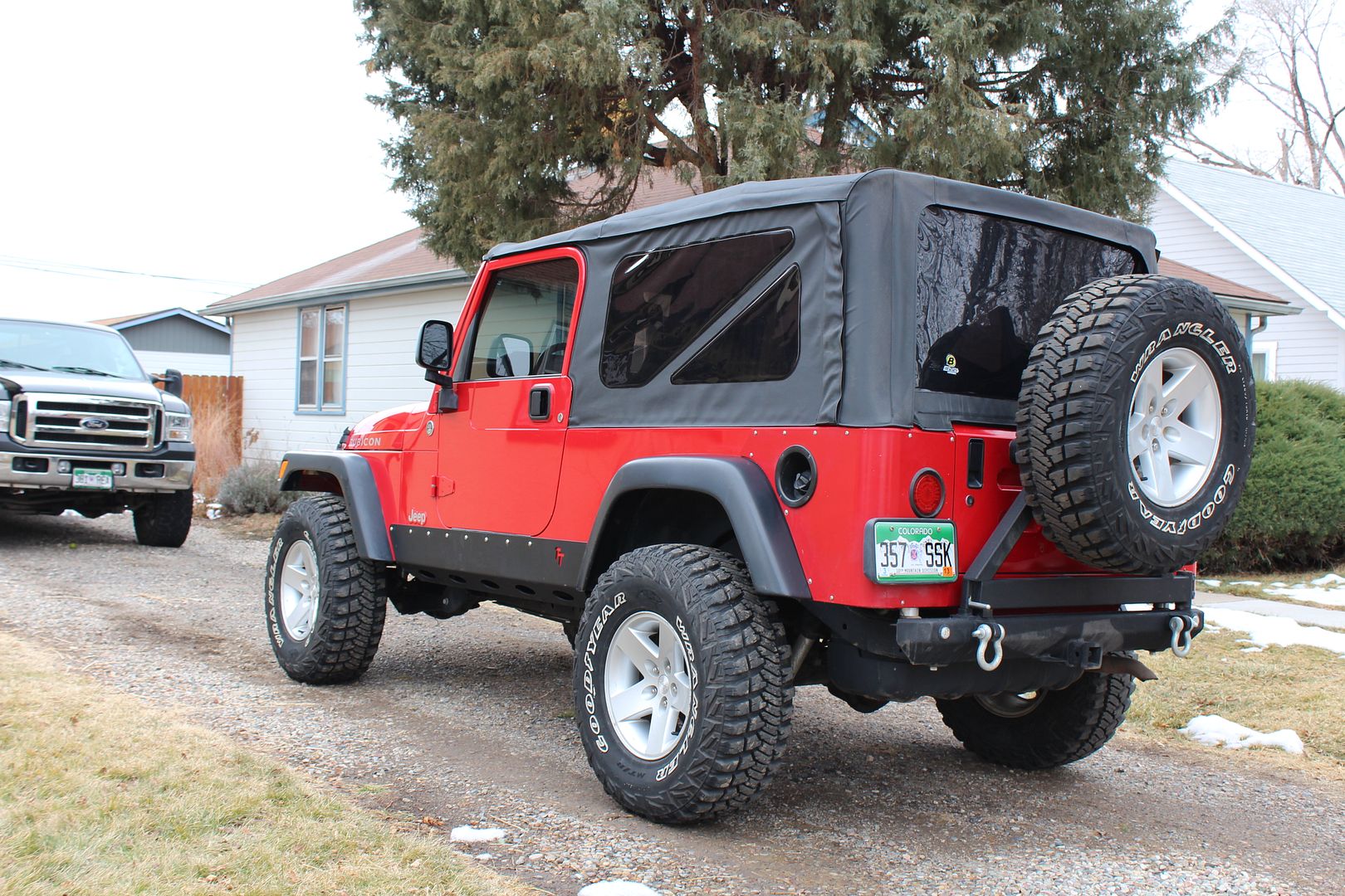

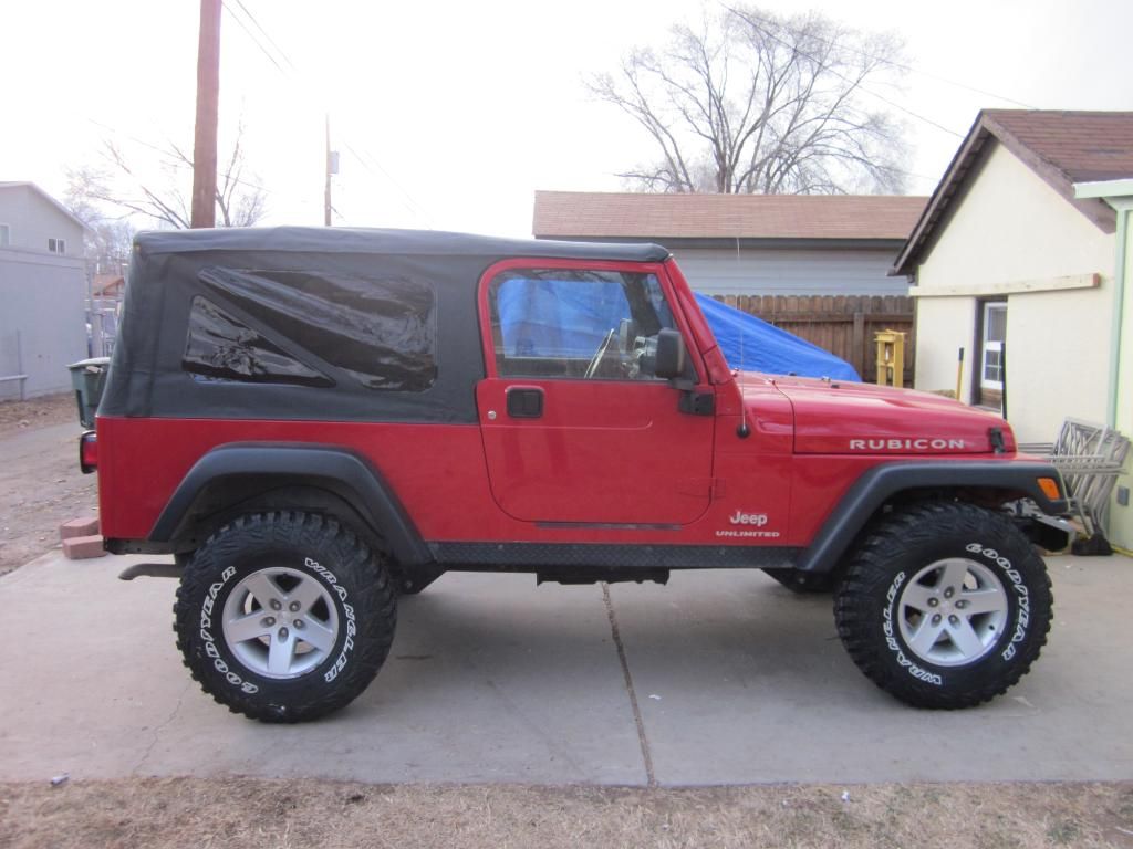

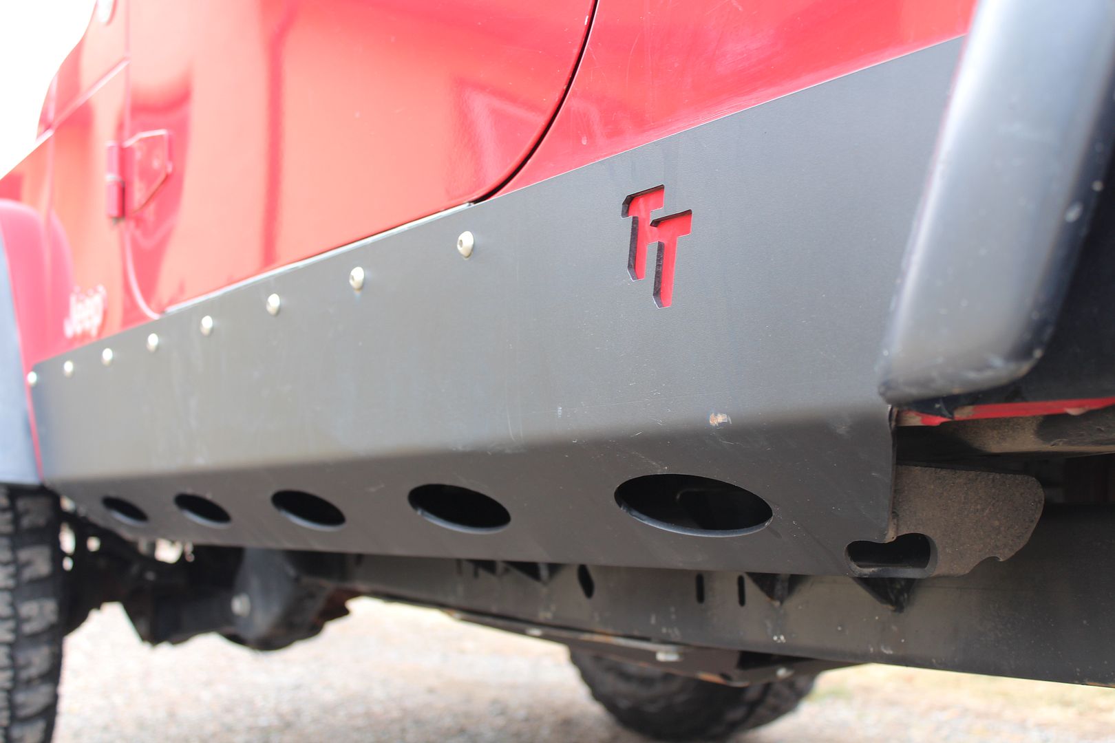

    Ok, FINALLY got around to getting some pics and an update. We installed a T&T Customs high clearance belly pan which gave us an additional 3" of ground clearance, some T&T Customs Guardian Rockers with the new high clearance body mounts, and mounted some 1" LED's for reverse lights. As of now the jeep is done, and serving as my Daily Driver along with the Superduty. The hard top is getting repainted and will be going on shortly, next mod, will be a 5.3L V8/4L60E/Atlas hopefully sometime this fall
    T&T High Clearance belly pan
    Guardian Rockers with high clearance body mounts
    LED Revers Lights
    Few shots of the final stance
